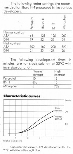

As far as plus/minus development goes, would it be fairer to say that more development increases density, and therefore contrast and less development reduces it?
Both increased concentration and increased time have similar effects - a darker negative. It’s juggling the side-effects of either system and combining them that fine-tunes the result.
In simple terms yes, but in reality the increase is far greater at the highlight part of the curve and very slight in the shadows, thus stretching the tonal range in low contrast situations.
This is from an old Ilford publication, "Perfect Negatives, Perfect Prints", I rearranged slightly. By High Contrast they are talking about development for low contrast subjects.
With more dilute ID-11 the % increase is much higher.
The time % increase for ID-11 above is over 50%. Isn't 20% meant to the standard for increasing contrast?
Ilford are not referring to Zone System nomenclature which uses the N + or - to indicate the increase or decrease. I don't have an old FP4 datasheet, but the increase for Pan F & HP5 in ID-11 is less. By Normal Ilford are developing to a contrast index of Ḡ 0.55, and High contrast of Ḡ 0.70, the first for Condenser enlargers, the second for Diffusers.
