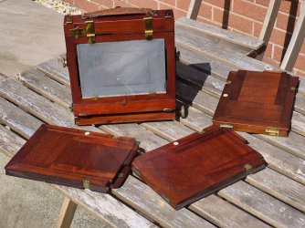

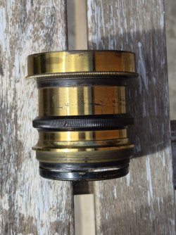

I bought this half-plate camera at auction last week, but neither the camera or lens has a maker's name on it. Does anyone have any suggestions of what it could be? I need to buy some small screws to re-attach the front standard to the hinges at the front of the camera.

Looks nice. Good job you got holders with it.

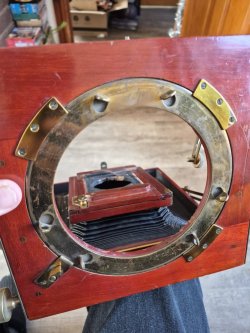

This is the tripod mount for the Houghton camera - what is the best/easiest way to adapt it to fit on a modern Manfrotto tripod? Would it be to fabricate a wooden piece to attach to the round section and insert a 1/4 inch thread into it?

There were adaptors made for this exact problem and you might be lucky enough to find one.
In the meantime, what you suggest sounds exactly right. Although it seems natural to locate the socket in the centre, you might take the opportunity to choose a different point of balance.
You could also provide for both sizes of tripod screw.

To save on weight you might consider making an adapter in the Y shape of the originals but it would need to attach to the existing brass ring. If you find pictures online you'll see what I mean. I've had a few of the adapters in various sizes over the years but always sold them because I didn't have any cameras that fit.

If we could make a CAD plan I'd happily laser cut you 18mm ply 'Y' with a 1/4 or 3/8 tapped in tripod bush ... Do it for the cost of the Tripod bushing if I can turn it into a video for my channel :)

I'd be up for that! Where are you based?
Great idea for a your channel , I have er now 5 Sanderson regulars that have the similar tripod ring - my “design” thoughts are around using a slot for each tripod lug in a wooden circle so they fit over the lugs and use a pinch bolt to secure, I have a couple of sets of the original tripod legs which are actually really stable and light but it takes some wrangling to fit the legs while holding the camera looks really nice
It's annoying, but I used to have a Thornton Pickard with a tripod ring like that - but I sold it. Otherwise I could have used it to take the measurements from.
Matt, I am not sure why you want a plywood insert that will fix to the metal ring and turn. To my mind a better option would be to remove all the metal and fix a plywood sheet directly onto the wooden base of the camera.
