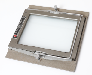

The difference, of course, is in the example you provided, the glass rests from the back on a routed lip whose T distance never changes independent of GG thickness. In my instance, the glass rests on a routed lip inside the frame and the effect T distance changes with varying glass thickness.
No, the same as yours.
Fits from the inside, so yes glass thickness is critical. It seems odd that Kodak would switch to a less accurate way of mounting
Sheet lass now is made to higher tolerances compared to 60 years ago, but even nominal 2mm can vary by +/- 0.15mm.
When film holders became International fit sizes post WW2, they were based on Kodak outside dimensions, with 5x5 the old 0.200" T registered was changed to 5.00mm / 0.197" +/- 0.178mm.
With 10x8 the T register is 6.60mm +/- 0.406mm. I'd measure that T depth register of your back. I will be improving the screen on the Specialist 3 back and will measure the glass thickness first.
