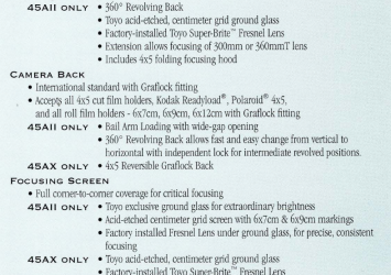

I don't think this has a fresnel, it is a Toyo 45AII. The screen at the front and the rear is smooth. I've got a fresnel somewhere that I could try on it.
I have an early Toyo Half Plater Field Camera, 5x4 back only,it has a fresnel, but it's extremely fine concentric rings compared to others, so hard to detects.
All 45A cameras were factory fitted with the same fresnel.
OK good to know it is so fine it's hard to tell.
If you remove the back and tilt it so you look obliquely, varying the angle, you can just make out the concentric rings. I need to compare my Toyo with my Wista, as I don't think it's as bright, or maybe rather less contrasty. I have a feeling that's down to the acid etched focus screen.

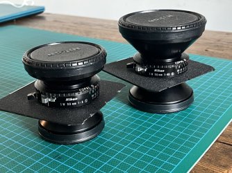

So finally tracked down the Nikkor 90mm f4.5. The seller was literally a 5min cycle from me. Very happy that I was able to compare against my 90mm f8. For me I don’t think the size difference or weight is that drastic. It’s a big difference in ground glass brightness indoors I must say. Very happy with purchase.
