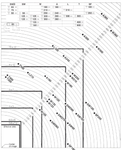

This diagram gives the coverage, up to 10 x 12, of the various Fujinon lenses. The W and SW ranges will be the most likely to be of use as they will cover 5 x 7 and, at a squeeze, almost to 10 x 8. I've also added the document that the diagram came from. I'm guessing that it was published in 1982.
  • Fujinon Lenses.pdf
