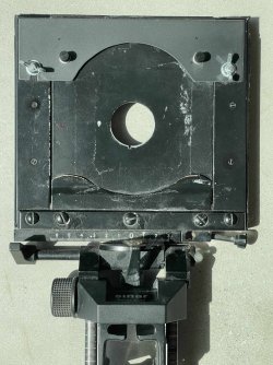

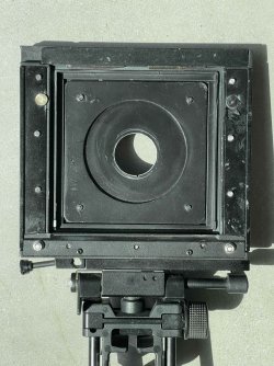

I just received a mixture of camera bits I recently bought. Amongst the items are a Sinar F2 with this customised front standard frame. Anyone seen this before? I can only guess it's to hold in a heavy lens. Perhaps over engineered?

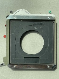

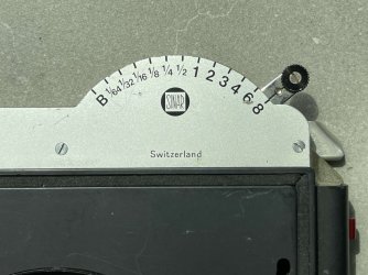

Also included is a Norma shutter with different shutter speed markings on each side. What's that all about? I really like this clean design compared to the later version with the aperture scale running vertically (which is redundant with non-Sinar DB lenses). It came with a nice all metal shutter release I haven't seen before. All the others seem to be black plastic coated. The shutter is essentially free after I split out all the other bits.

Interesting bits you picked up. The holders definitely look like they are for heavy lenses.
