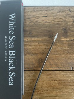

Here's some of mine....
I have two. cable releases.....A short all metal one I've had since 1968 (NOT a braided metal cover but a spring type cover! ) -
I aso have a longer plastic cheapo...just in case................... :D

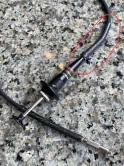

This is my current cable release. I don’t know how the bottom plastic has separated. It’s getting worse hence me wanting to get a better quality one.

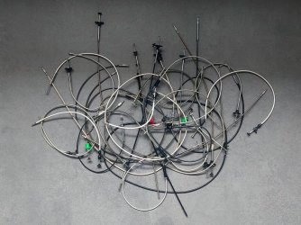

Like @MartyNL I have quite a lot of cable releases. In recent years I've bought them in bulk at Camera Fairs, back maybe 2007/8 I asked a stallholder how much are your cable releases, you can have the lot for £20, there were more than 20. I think I sold one that covered that purchase, it was non-standard in terms of fit.

Every similar cable I have or had with plastic tube covering has parted like that. It's not the plastic, it's the metal spiral tube inside, it's an expanding spring, each use it opens slightly.
