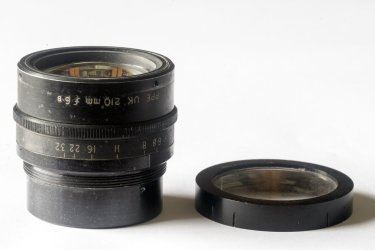

Hope that this is ok to post. I have a PPE (Pilkington Perken Elmar) barrel Lens 210mm f/ 6.8 Double Gauss designs which would have been made in St Asaph on the North Wales coast when there was a collaboration between Pilkingtons and the US based business. Its in poor condition and needs a really good clean and service (muck, a bit of fungus, etc) but has an additional close up lens included. I'm not sure of coverage but something in excess of 5x4 I think, possibly much greater. I do not know what the lens was for but I am told, by someone who knows, that it should be ok as a camera lens. So if someone in Wales would like a fairly unique 'made in Wales' lens they can have it for postage. It really belongs in Wales and should be used in Wales too!

Great, do pm me. Here are the photos including the close up lens (on an 1890s TT&H Cooke):
Its probably usable as is - I use a lot worse lenses with seperation, scratches and more, with surprisingly good results. Some of my oldest lenses (1860s) have clearly been very heavily used in the past and they show it!
It looks a very solid, well made lens. Almost industrial. Thanks for posting.
It was probably used in some sort of copying environment, not sure what though.
Perken Elmer a US company worked with Pilkington Brothers between 1967 and 1972, at their St Asaph factory. They produced lenses for optical masking for the manufacture of micro-semiconductors, for a US Air Force contract. Also for copiers & cameras.
This lens is probably optimised for close focus work, reduction by projection.

So they are intended for small aperture use and in common with many such lenses will probably perform quite adequately at infinity stopped down.
Just tried it on a Sony (central definition) at infinity and whilst contrast is perhaps slightly lower than it could be (marginally), central definition is very good. So a very usable lens.
