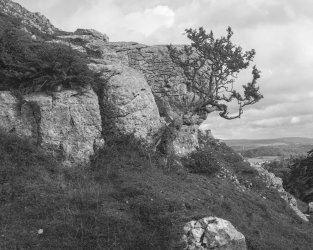

Crown Graphic 4x5, 135mm Optar
HP 5+ at box developed in homemade Pyrocat HD, 1+1 for 14 minutes @ 20, Regular Ilford agitation.
Naturally formed limestone rock with fissures and Hawthorn tree bent by the wind until sheltered behind the rock.
Yes Ian your right and its thanks to your suggestion and recommendation that I adopted it
I deliberately went to the low contrast end of the spectrum and it worked as anticipated, my intention is to up the time to 15 and then 16 until I get the right contrast, for me, with HP5+, although I did anticipate more adjacency effects.
I miss the 510 though, in using only one 100ml bottle I gained the confidence to increase temperature and reduce time, increase/reduce the development time for zone manipulation, I found it very easy to manipulate and, most importantly, consistent.
I have bought some Pyrogallol just in case I didn't find the Pyrocat HD as "adjustable".
But after the first test run, I am impressed and now sure that I will stick with it a while and get the hang of it eventually.
