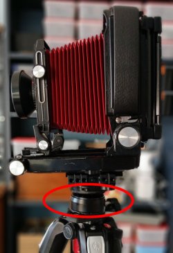

May not be relevant but if doing away with the head is your main objective then have you considered a leveling head? Not really a head at all but a half ball that gives 15 degrees of tilt in any direction which is usually enough for levelling.
Thanks; I wasn't aware of these. But I was thinking of something with a bigger area at the top of the tripod, for more stability.
They are available in different sizes. I think I've seen them up to 90mm. Mines a 60mm and supports my Toyo G (5Kg) no problem. But I understand it may not be what you want.
I can see how this would work for you, and I might even get one as it would be a more rigid alternative than using my B&S head. But, yes, I was thinking of something wider. I'm thinking in terms of a wooden disc with a diameter of about 140 to 150mm, with the tripod legs permanently attached to its perimeter.

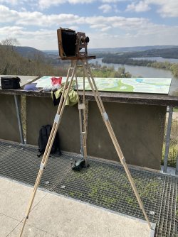

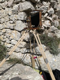

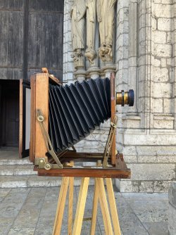

The detachable legs take a little getting used to, and you can't tilt the camera much. My Gandolfi half plate camera came with a light weight wooden tripos which is robust in terms of stability, it needed repair, but that was relatively simple. I have an advert for it in a BJP Almanac (it's not a Gandolfi tripos).

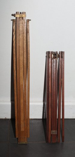

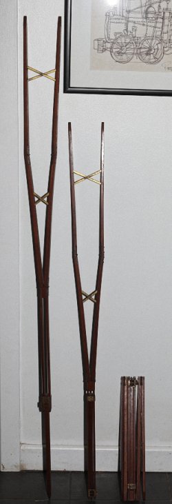

You could make a Gandolfi style tripod the smaller ones are light and very stable. It appears they are derived from earlier camera stands, but with folding and extendable legs, this from an 1898 Ross advert.
Looking at the 1898 Almanac what are referred to on eBay etc as adapters are in fact part of a tripod set and sold with the set of legs.
Ian, yes, your second photograph shows the kind of thing I had in mind, but with the camera sitting on it and rotating. Thanks.
