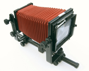

Lastly, can anyone tell me how to go about fitting a fresnel screen to the cambo? is there anything I should looking for?
Its my understanding that they can be fitted and go on the rear side of the ground glass so to not shift the ground glass registration but any help and advise would be great.

My Cambo Cadet came with a very thin plastic fresnel, I'd assumed it was standard, apparently not.
Here it is fitted on the rear, it was a really bright screen.

My Cambo does not have one fitted so I presume it may well have been an optional extra, I will look into an aftermarket one and try to figure out fitting as I am finding it difficult at present in some situations trying to see and focus. I am sure this is however something I will get used to.

I've just bought a Chinese fresnel for one of my MPP cameras, just under £30 inc postage.

After a quick email to intrepid I have just ordered one of their Fresnel screen, It turns out that its the exact match for the cambo in regards size etc...
