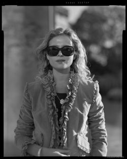

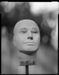

Does anyone have any info on a 7 inch f3.4 Aldis Butcher lens? The internet says it's a Cooke triplet design. Originally designed for 1/4 plate it covers 5x4. I fitted it to my Super D in a homemade lens board. Can't reach infinity, rear element protrudes too far. Furthest is around 2 metres. This is a test wide open. Foma 100 (expired 2022), ISO 50, developed in Rodinal 1+50.

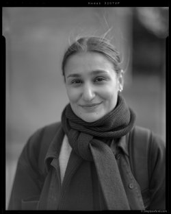

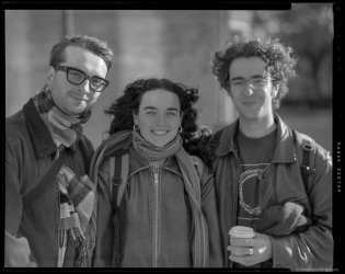

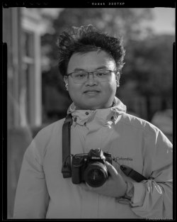

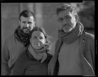

Finally got a dry day last weekend to test this lens on the street. Gale force winds didn't stop me but I did almost lose the camera a few times. Kodak TXP 320 (expired), developed in HC110 1+31 in a Jobo drum. Mostly around f4.5. Need to stop down more for two or more people but this is what testing is for.

Just out of interest which Jobo drum are you using? I've not yet built up the courage to try 10x8 in a 2800-series drum or built up the capital to invest in an Expert drum and upgraded processing unit, but I can't help notice some dark stripes along the film rails on these images.

I don't have the drum in front of me but it's the one which holds 2 x 2509n reels. I loaded 4 sheets in each with an empty slot in-between and I use a roller base and rotate manually. I see the lines on the edges, maybe I rotated too quickly?
Ah sorry, for some reason I had brain failure and thought these were on 10x8 (perhaps thinking of another recent thread). I do sometimes get a slight hint of line like this on my 2509n reels but for some reason never on E6, even filling all the slots on fast speed.

Really nice Nas. I really like the frame with the female with the scarf. Insane you shooting wide open. I just love the tone rendering of tri-x. The creamy highlights do it for me compared to hp5. Shame it’s unrealistic to shoot for me due to price.
Did you shoot at ei320?
Thank you. I can't afford fresh TXP 320. The film I used has expired, I rated it at ISO 200.
