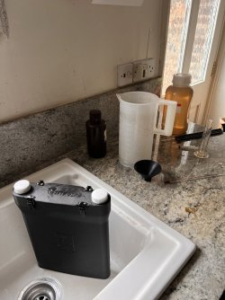

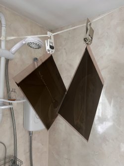

Just developed a couple of 8x10 negs. I made a mistake in that I didn't increase the volume when just one slide was used (for 2 negs). Ideally you should be using 2 litres of fluid for this tank instead of the 1.8 litres I used here. I did stand development in 510 Pyro at 1:500 for an hour. The development seems fine. I was also testing my mixed up 510 Pyro as I wasn't sure if was going to be OK due to the age of the chemicals. I measured the small quantity of Pyro by weight (1.22g per cc) to get it accurate for such a low dilution.
