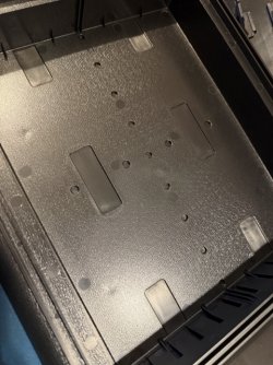

there is nothing but glass on the back of plates right? They are heavy and don’t slide around unless you slosh the dev etc so hard that it comes out of the tray ? Here is the inside of my 810 , scrap sheets would protect it but might also allow plates to slide more easily . Oh new phone pics too big to post will try later
Scrap neg sounds a good idea and keeps the tank in its original state.

Here is the textured base of the 810 , std procedure for film is to pre soak to get the sheets to sit down on the base - texture helps them not stick - it’s quite delicate so I can see why there is concern ref damage
