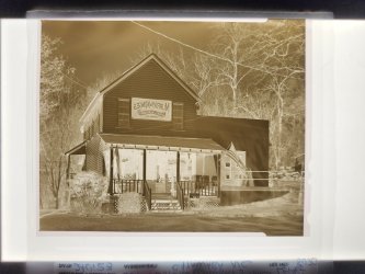

The negative was digitised with a Nikon D850. It is imported into Photoshop, where I keep the colour profile and invert it by flipping a curves layer, and indeed, it turns a pale blue. If you colour balance by using the "eyedropper" on a neutral colour, in this case, I utilised the facade of the building; it magically returns to the original colour. Here is a phone picture of the negative for colour reference.If the negative was scanned in colour and then inverted, the positive would be slightly blue toned.Try inverting your image.

The negative was digitised with a Nikon D850. It is imported into Photoshop, where I keep the colour profile and invert it by flipping a curves layer, and indeed, it turns a pale blue. If you colour balance by using the "eyedropper" on a neutral colour, in this case, I utilised the facade of the building; it magically returns to the original colour. Here is a phone picture of the negative for colour reference. View attachment 4495
