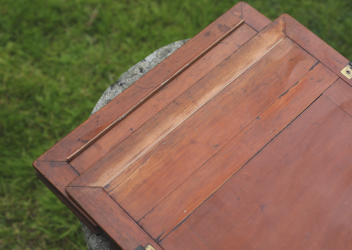

I had some wooden book form plate holders modified to fit a no-name half-plate camera I bought back in the summer. They're finally finished and the cabinet maker who did the work has posted a video about the project. Bearing in mind this is not the typical kind of work he does, the end result is fantastic and the holders fit really nicely now.

I acquired an old half plate mahogany and brass field camera for next to nothing some years ago, quite like the one in the video above. But I took an alternative step. I converted the camera back to take modern 7 x 5 film holders. This turned it into a very practical and easy to use camera.
I've had the same done to a whole plate studio camera. The camera in the video above cost me £35. The work on the plate holders cost 10x that.
What?!?!! oh my gosh. I’m in shock
So was I when I received the final bill. We've all got to earn a living and I appreciate all the overheads etc to keep a workshop running but I'm just putting this out there in case anyone else has a similar project. The biggest problem was not being able to get an estimate before any work started.
I understand fully. Seemed like top work I must say.
It is very difficult with repairs or modifications like this, The time involved adds up quite quickly, which makes it hard to price up, and often justify the final costs.
I had to repair three 12"x10" Plate holders last year, one had significant splits, in almost all cases the actual dark-slides had shrunk and no longer locked onto the end light trap.
A similar job to adding wood to make the Plate holders fit in the video.
