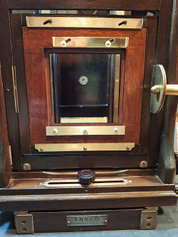

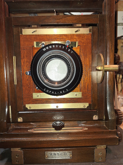

I don't know if this is helpful but this is how I solved the problem for my Ansco 8x10 overhaul. That camera natively takes 6x6 lensboards but everything I already have is in Wisner 4x4 boards. An adapter was called for:
I have 3 conversion boards for my Agfa Ansco 10x8 cameras, I made one for Linhof/Wista lens boards, a second came with a camera, it took Graflex Pacemaker Graphic lens boards, it needed tidying up. I realised with very slight modification I could use it for both Pacemaker & Linhof/Wista boards,
The 3rd converter board takes 6¼" x 6¼" lens boards that fit my 12"x10" field camera, it is also happens to the same size as a large Toyo lens board.
I do have some lenses on MPP MicroTechnical (MkIII - MkVII) / early Speed Graphic, 4"x4" lens boards, mostly shutter-less barrel lenses, great with my Pre-Anniversary Speed Graphiv and focal plane shutter. I have an adapter to fit my Sinar shutter to my main Agfa Ansco 10x8 camera. All 3 lenses that cover 12x10, a 12" Wray WA. then 17.5 TT&H, and unbranded 20" RR, have the same RPS 3" flange thread, and I have 3 flanges, so one board for the Sinar shutter can be used with all 3 lenses. Then I need to make a converter board to use 4"x4" boards.
