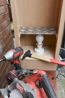

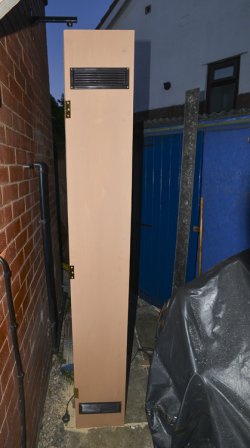

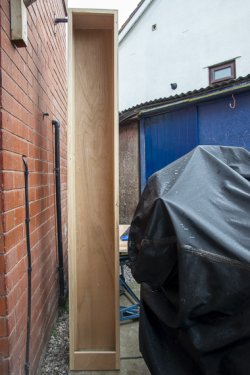

Film drying cabinet - has anyone tried making one?

I don't push it all, the light bulb heats the cabinet so slowly that, in my process, The first thing I do when developing a batch of negatives is wipe down the inside of the cabinet and switch the switch the light on !
I have not carried out any abrasion resistance tests as not noticed anything, so far, that causes concern, A good point to raise though that there is a significant difference between touch dry and "through dry".
