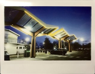

Here's a shot from yesterday using one of these adapters in a homemade 5x4 camera (not made by me), Schneider 75/8 lens. Film developed in a LomoGraflok back.

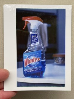

Following on from my original post almost a year ago. I have in discussions with the guy who designed the 3D printed adapters for 5x4 and he designed a half-plate version for me to test – which I did yesterday with great success. His original half-plate dimensions used the old wet plate dimensions but this new one fits into my recently modified wooden dry glass plate holders (mentioned in a different thread). I focussed on the label and it's right on. Much sharper in real life than this phone snap.
