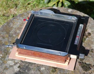

As some here know about 3 years ago I picked up a Sinar Copal shutter at a camera fair for £20. I assume the seller thought it was broken as it would fire when a cable release was used. NAS saw it on a visit to my house, then went to his car returning with his special heavy duty, extra long throw, Sinar cable release and it worked fine.
I don't have a Sinar camera or any relevant lens boards, initially I thought of front mounting to a lens, not ideal. So how to attach to a 7"x7" wooden lens board? Then how to attach a lens in front? This need a bit of lateral thinking. . . . . . . . . . .

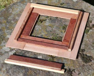

The answer has been to make an adapter to slip the shutter on a lens board, and lock it in place, I began by making the frame it sits in.
The shutter has 2 lips, the top one fits under a wooden bar at the top, the separate piece of wood slides in when the shutter is in place to lock it in position. It will be screwed to the lens board when completed, allowing easy removal of the shutter if needed.
I decided in the end to make the lens board an integral part of the adapter.
Actually the shutter is being used the wrong way around, normally the front fits the rear of a Sinar front standard, instead of the bellows, which are the attached to the rear of the shutter, but as the shutter speeds are marked on both sides of the adjuster, and I'm not using Sinar DB lenses, it is not an issue.
It is still a work in progress, mostly finishing the lens board and tidying up cosmetically, before refinishing, 7 painting.

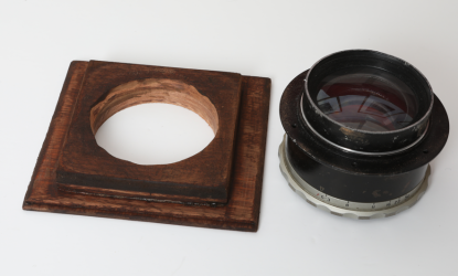

My biggest lenses fit the same flange, so Wood or Aluminium lens boards, maybe one that adapts to take Linhof/Wista as well as MPP/speed Graphic wooden lens boards, (these two are identical in size).

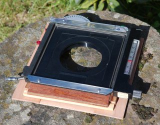

I had a good think and decided to where possible mount my barrel lenses on 4"x4" lens boards. These are used on early Speed Graphics as well as MPP Micro Techical cameras (MkIII - MkVII). I have a pre-Anniversary Speed Graphic which I completely rebuilt a few years ago, it's fine for outdoor use but flash sync is not possible.
The 4"x4" lens board adapter to fit the Sinar shutter is now almost complete, it just needs final finishing and a slider and retaining strip of brass fitted.
Is it not mounted backwards..?
It is, deliberately.
This way around I can easily fit wooden or metal lens boards. They aren't designed to be fitted directly with a lens board, the side normally facing the lens clips into a Sinar front standard. The shutter can be removed from its adapter, there's no modifications to it at all.

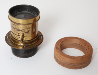

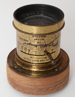

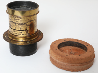

You have made me think as 2 of the 3 lenses hat fit my 12x10 camera protrude backwards from their flange, max though is 2 cm, and they share the same RPS thread 3" flange, so a special 4"x4" lens board, sort of mini top hat.
Just needs the slider,etc.
This is one of two lens boards for the shutter, this one allows me to fit my 12" Wray Wide Angle with its protruding rear elenent

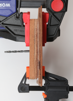

Will drill tomorrow to the correct diameter.
Not finished , but I had a thought.
Look what I cut out, could I use it ? I don't own a lathe.
Not perfect but hey it will work perfectly :D Will make the rest of the lens board to attach it to tomorrow.
Just need to make the sliders for the 4"x4" adapter, and screw these lenses to their boards.
