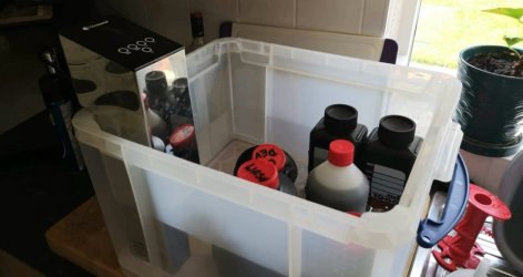

For keeping everything warm i use a plastic storage box filled with water with a sous vide hung over the edge, just enough water so the bottles don't float but enough for the sous vide minimum levels. All the bottles that need to be up to 38°c sit in there. For a while before developing i put my developing tank into the water too with a large chopping board over the top to allow the tank to stabilise.
Just watch out for which sous vide you opt for, some don't go down to 38°c

I have two plastic storage boxes and two Cinestill heaters, one for heating chems and one for tank inversion/wash water.
