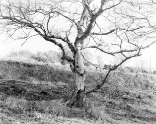

I'm very surprised at this. I love HP5. It comes alive in dilute ID11 and dilute Perceptol. Here's one, of a silver birch tree, from a 5x4 sheet of HP5 developed in ID11 diluted 1+2.silver birch.jpg
I'm very surprised at this. I love HP5. It comes alive in dilute ID11 and dilute Perceptol. Here's one, of a silver birch tree, from a 5x4 sheet of HP5 developed in ID11 diluted 1+2.View attachment 6319

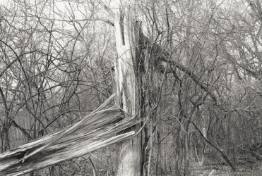

In some degree, it's a matter of taste and personal aesthetic. It may be a "me" problem, but I've never gotten anything out of HP5+ I loved with anything other than PMK, noting that I've not ever used Perceptol. It's also worth pointing out that I am strictly a silver printer and how I approach split VC printing is also a factor here.
Here is one example of my preferred rendering. This is from 3x2 HP5+ shot with a 101mm f/4.5 Ektar, processed in PMK Pyro, scan of silver print:

By coincidence, we have two adjacent examples of different printing styles.
The splintered tree is very gentle, whereas Avebury Ring is very bold.

We might try visualising how each photographer would print the other’s negative. Then we might infer what their individual developing preferences might be. And from that, their film and developer preferences.
(I’m trying to use non-photo terms here.)
This is very much to the point. How each of us visualize a scene, meter it, process the film, and then render it - either by print or via scanning - profoundly influences the outcomes and, thus, our preferences.
So, when I say that I've only gotten good outcomes with HP5+ when using PMK, what I am really saying is "For my own way of seeing things and printing them, that's the only developer that I have gotten to work well with HP5+."
