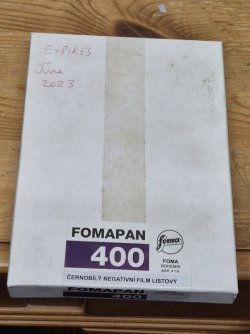

I've just found an unopened box of Fomapan 400 5"x4" that I bought new, but expiry date is June 2023. Is it best to rate it at, for example, 200 ISO or to increase the development times (or both)?

I'd be rating it at 200 or less, but not because of the age, but because it's Foma. Their datasheet makes it clear it's not anywhere near 400 except in Microphen. Age wise I wouldn't do anything special, it's practically brand new.

Fomapan 400, is actually an iso 200 film. Foma quotes the speed according to the density @ Zone V, rather than the Zone I of others. I'd rate the film @ iso 125~iso 160. Do a test shot first to determine the proper development time.
When companies acquired ISO8002 accreditation their product expiry date shad to be significantly reduced. This was more about stock rotation than possible deterioration.
I'm regularly using film that is much older than 2023, some is from the last EFKE and Forte coating runs, They behave as well as when bought new, no issues.
