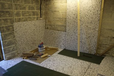

I insulated my shed, it's part old farm walls and breeze black, I battened lined the walls and floor with polystyrene sheets (polythene sheet underneath on the floor.
The floor is important in cold weather, then I used flooring grade chipboard, and plasterboard on the walls. The roof is also well insulated, there was already power, I just needed to add water and drainage. The window was already double-glazed, and I insulated the door as well.
It's cool in the Summer as long as the door isn't left open, and warm even with a hard frost. I do have a small freestanding radiator I keep set low in the winter.

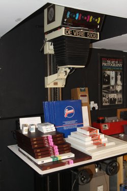

The actual layout is slightly different, the benches are as in the drawing, but the bench with the two Durst enlargers is now a computer bench with dual screens, a V750 scanner. My A3+ Epson printer has not been used since before I moved 10 years ago. The bottom right wall has a bookcase with technical books and my collection of BJP Almanacs & annuals.
Yes, there are still 5 enlargers, 3 are for sale. I need to declutter.
