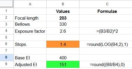

Would you like to talk to me about exposure compensation for bellows extension?Horseman L45 monorail, Kodak Ektar 203mm lens, Ilford HP5+ at box speed, developed in HC110 Dilution H
Amaryllis No 4 by Kevin Allan, on Flickr
By the way, I took two versions of the amaryllis image, because I forgot to apply bellows compensation the first time round. Despite a difference of almost 1.5 stops, I can't tell any difference between the two negatives. Perhaps that's a testament to the flexibility of HP5+Would you like to talk to me about exposure compensation for bellows extension?
Thanks for that. I generally shoot colour positive film which is not known for exposure latitude.By the way, I took two versions of the amaryllis image, because I forgot to apply bellows compensation the first time round. Despite a difference of almost 1.5 stops, I can't tell any difference between the two negatives. Perhaps that's a testament to the flexibility of HP5+
In my personal experience, depth of in sharp focus is wafer thin using an 8x10 camera with a 360mm lens even at its optimum aperture.A couple of points to remember. You can get tables. Just do a web search.
Secondly, opening the lens to compensate will reduce depth of field. As you will only need these calculations when depth is very small already, it might be best to extend the exposure time.
Which leads us to (thirdly) reciprocity failure. This is the last factor to apply. Once again tables are available. The best thing is to download an app and use that. So much easier than mental arithmetic under a blackout curtain.
Reciprocity values (I think) can be gleaned from Kodak via the web.
Is there a general "Rule of Thumb" that can be applied? Like the four square rule perhaps?
