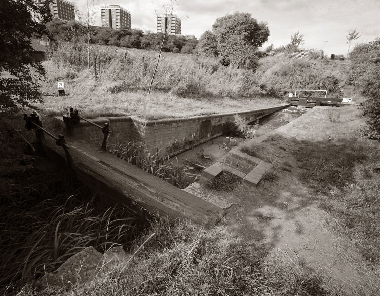

From "In Search of Agenoria", this is the original top lock in the 9 Locks flight, the flight of locks collapsed due to mining subsidence and replaced by a new flight.
Hi Ian,
The angles are really interesting; for my learning, what movements were used and what effect did the super wide angle lens make.
Robert
Robert, I guess I used a little front tilt. The 65mm isn't the easiest lens to use on a Wista 45DX, I use maximum rear tilt (backwards) then the same with the front tilt using front rise to centre the lens - otherwise you get the front of the focus bed in the image. It sounds difficult but actually it's quick and easy in practice.
It's a very tight location I'm about 2 ft from the nearest edge of the lock, so using the 65mm has exaggerated perspective, plus tere's no way I could control the diverging verticals of the tower bocks and a tree (top right). The old 65mm f8 Super Angulon only just cover 5x4 so movements are very restricted. As it is I've always thought the image works well so it's printed on 24x20 in paper in the exhibition set, actual image is about 20x16.
With any extreme wide angle lens the effect of exaggerated perspective depends how much fore ground detail you're including as well as the angle you're shooting at, this image made with the same lens doesn't appear to have been taken with such a wide lens.
So it's how you use your lenses, I'm actually not a big user of extreme wide angle lenses in any format, I've used the 65mm I'd guess less than a dozen times since I bought it around 1989. However when I have it's meant I've been able to make images that would be impossible with longer lenses.
