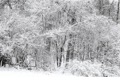

OK, so here is a scan made by sandwiching a 35mm negative emulsion-side up on a flat bed scanner with a piece of glass on top, and then laying the LED light table on top of it. I didn't have 5x4 neg handy but I'll try to get to that as well at some point.
Some very light curve adjustments and sharpening in GIMP thereafter.
This is using a very basic Epson ET-2760 office scanner, scanned at 1200dpi and 48bit RGB.
I certainly don't think this remotely competes with a V850, but it's not useless either. Like I said, this is helpful to examine negatives before I print them - sort of a digital contact sheet...

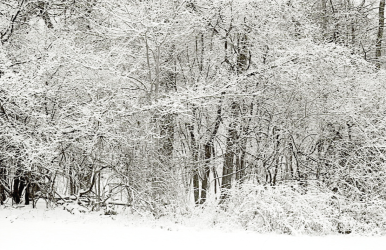

By comparison, here is a scan of a silver print made from that negative.
In both cases, there seems to be is definitely some reduction in quality by the forum software downshifting the image resolution. If someone really wants to see the full resolution of the Fibber McGee Scanning Solution (aka FMSS) above, I can always post somewhere on the web.
The larger point, I think, is that the FMSS is actually surprisingly useful. If/when I have time, I shall rinse-repeat with a 5x4 negative.

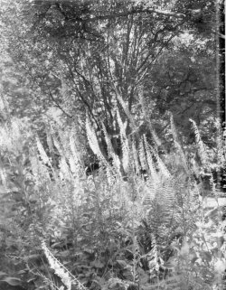

This is rejected 10x8 neg, and I think you can see why.
This was done on the kind of flatbed scanner that seems to be included in an ordinary desktop inkjet printer. the neg is just dropped onto the glass with nothing to hold it flat. The scale on the right is from the LCD light panel. All scans done with VueScan.
I found that I had to turn the light panel down to its lowest brightness and even so, the highlights are still burned out.
I hope this is useful to someone. Clearly, more work needs to be done.
Depending on the light panel's output, you may have to position it above the actual scanning surface a bit to get the light output down enough to capture the highlights properly.
