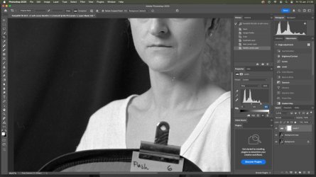

Hey peeps,
I did a test roll of fomapan 200 to see what the latitude of the film is. It was under very controlled conditions, strobes.

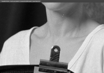

I rated the film from EI25-EI800. Development was great no issues there. What I found on all frames is salt and pepper like spots. It’s all over, like a layer above the image. Under a light box I noticed them. I scanned the very first one and was amazed that it’s all over the place. It affects you finding the black and white point and editing the frame.
My question is, has anyone experienced this before and is this also something that happens on fomapan 200 sheet film? I bought a box of fomapan 200 but wanted to test on roll film with my roll back instead of burning through sheets.
Here is a cropped section of the image. The salt and salt dots is on all frames no matter how I metered.Image 10-01-2025 at 21.38.jpegImage 10-01-2025 at 21.31.jpeg

No idea what's causing that but I can at least confirm it's not normal for that emulsion.

Might be hard to see but if you look at the emulsion side of the film at an angle with a loupe you can sometimes see if stuff like this is a defect in the emulsion, or particles stuck onto the emulsion, or even something on the other side of the film. Hard to say though. My money would be in some defect in the manufacturing, would not be unheard of.

Some foma films don't like an acidic stop bath so try with just water

Plain water works perfectly well with film. The amount of developer absorbed by the film emulsion is very small and is soon washed out in a water bath.

As David said the water stop works well with film so I would give it a go. I think there was something going on that bubbled something in the emulsion with the acidic stop which leads to the dots.
I've seen this before with expired EDU Pro 200 sheet film, which is just Fomapan 200 rebadged for Freestyle in the US, and there are a few posts about it on other Forums. I've not seen this with any other Foma films I've used. I only used water stop baths for films, since late2006.
I find foma loves to hold air bubbles, although I'm not sure this is air bubbles. I always give the tank a few really good thumps on the counter after each agitation
