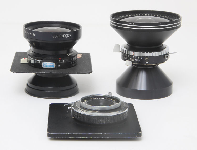

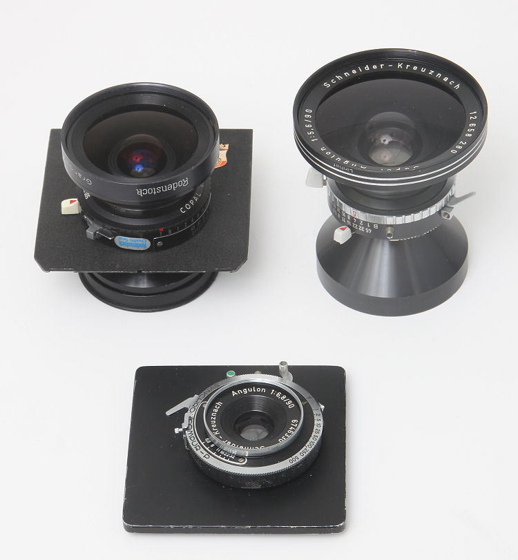

    Here's 3 90mm lenses:
    [​IMG]
    A 90mm f6.8 Grandagon N, 90mm f5.6 Super Angulon and a 90mm f6.8 Angulon
    [​IMG]
    The tiny Angulon is a considerable saving in terms of weight and size however it only just covers 5x4 but very capable if used acrefully, quality of early one's was sometimes suspect but all OK after SN 5,000,000

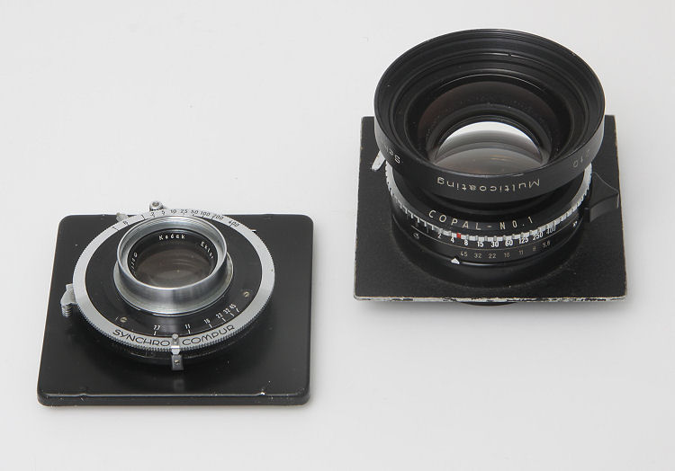

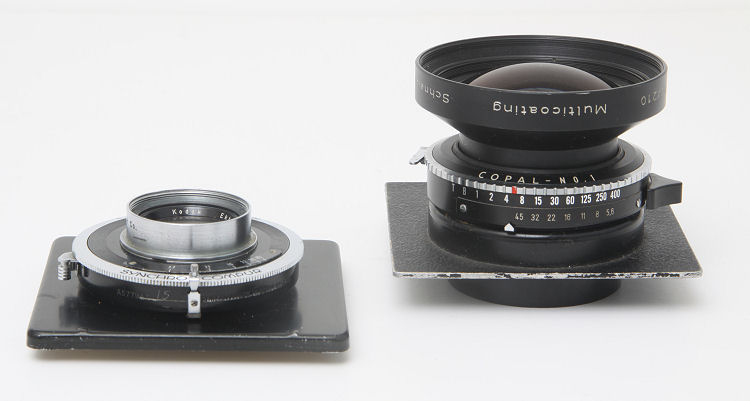

    Here's another example 8" - 210mm lenses:
    [​IMG]
    A 203mm f7.7 203mm (8") Ektar very late US version and a 210mm f5.6 Symmar S
    [​IMG]
    Plenty of coverage with both as they cover 7x5 with room for movements.
    Weight IC mm f22
    210mm f5.6 Symmar S 569.8 g 294
    203mm f7.7 Ektar (US) 256.7 g 216
    210mm f6.3 Osaka Commercial 255.4g g 235
    210mm f6.3 Geronar 323.1 g 230
    You can see a very significant weight and size difference between the Ektar and Symmar S. The Ektar is a very sharp lens an excellent from Infinity to 1:1, if you can find a late UK made version they are in a Compur #0 shutter (with preview lever) earlier versions are in Epsilon and later Prontor shutters you need to set to B or T to focus. The US version is usually in a Supermatic shutter excepth the very last ones made which are in a Graphex Compur #1 (as above).
